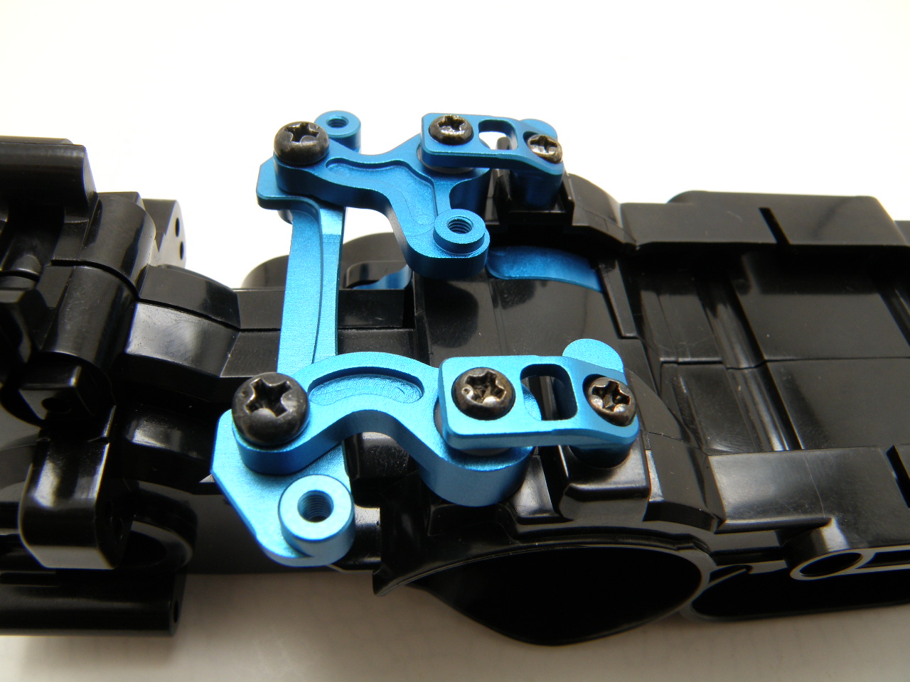

各位師兄,唔洗等甘耐啦! M05金屬轉向出左拉,一套五件,一D虛位都沒.
我仲要做其他M車零件,有興趣留意近期自作業團購啊,

金屬轉向太重了!

個人意見: 件料係米厚左D呢, 定係影相角度問題. 同埋會有咩色, 定係藍色ONLY.

諗黎諗去諗唔明點解無人出碳纖轉向板,下下出重金屬重GPM年代咩!

轉向板用碳纖都好,不過樓主另外o個幾件都似乎真係用金屬好?!
sing.kh8212 發表於 2009-8-6 17:47:05 | 只看該作者
有.碳纖好D

件料厚度一樣,系角度問題.可以做藍,灰,黑色

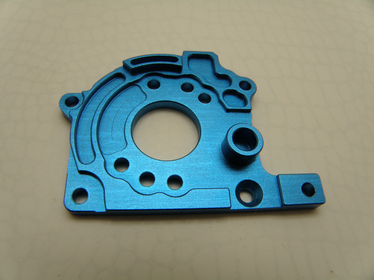

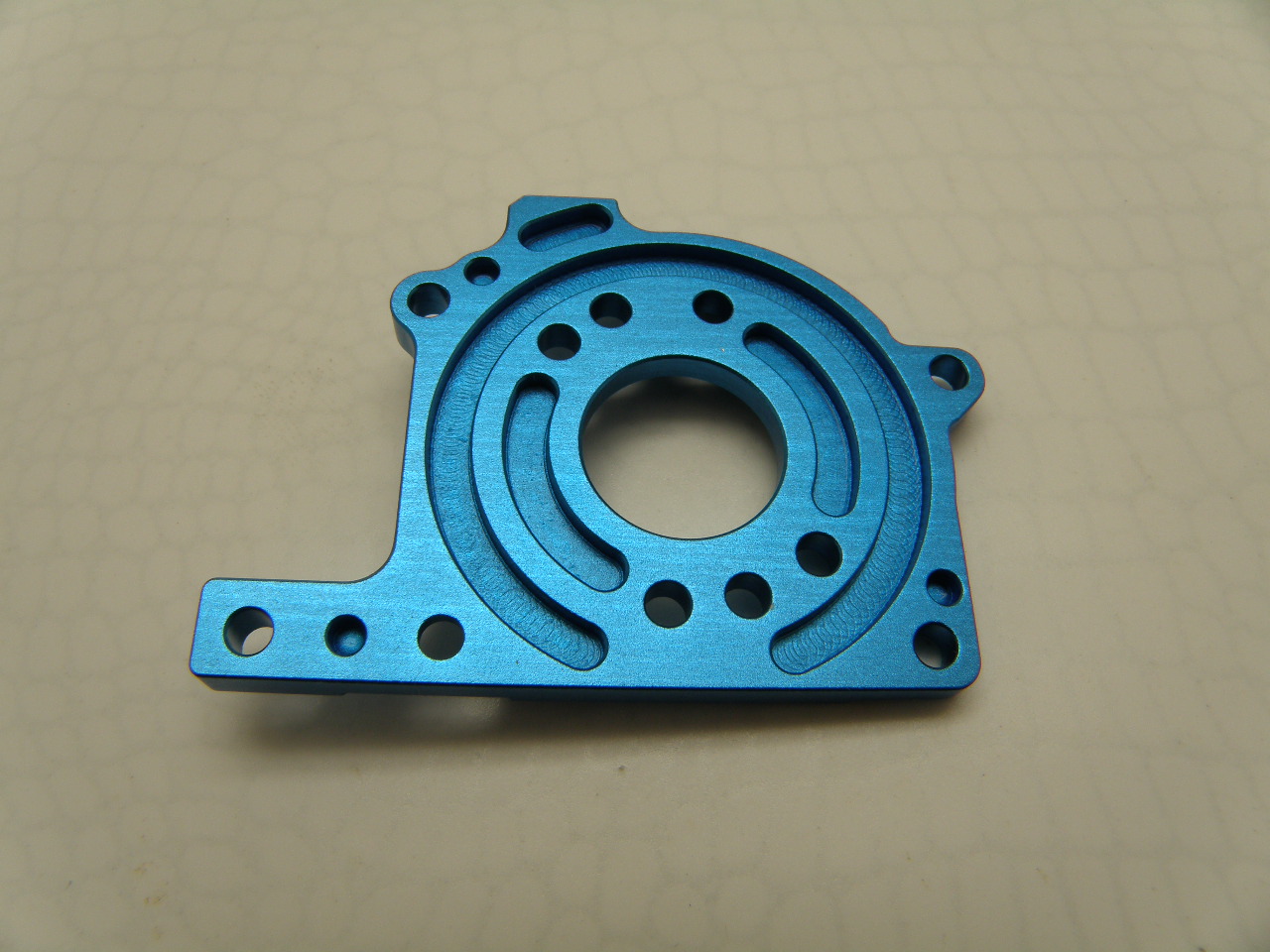

我會再偷輕D件,衣架膠件五件(B3*2,B6,B7,B10)重5g,我最后偷空曬系8g,但沒虛位,轉彎好好多.
馬達座膠件(B2)重5g,我最后偷空版系8g,膠件強度同散熱差好遠.
唔系咩件都可以碳纖做噶嘛,例如B6,B7,B3,B2

personal idea, I also suggest to use carbon fibre board for steering plate.  But i suggest to drill a series of holes at the steering plate so that the ankernman could be adjusted.  drill a series of holes like the holes in damper plate

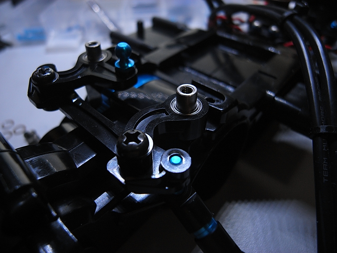

摩打座我都買金屬,我份轉向都無虛位睇你識唔識攝
我都講明係碳纖轉向板唔知你偷笑咩?
清清 發表於 2009-8-7 00:06:05 | 只看該作者
personal idea, I also suggest to use carbon fibre board for steering plate.  But i suggest to drill a series of holes at the steering plate so that the ankernman could be adjusted.  drill a series ...
chrishkyung 發表於 2009-8-6 23:30

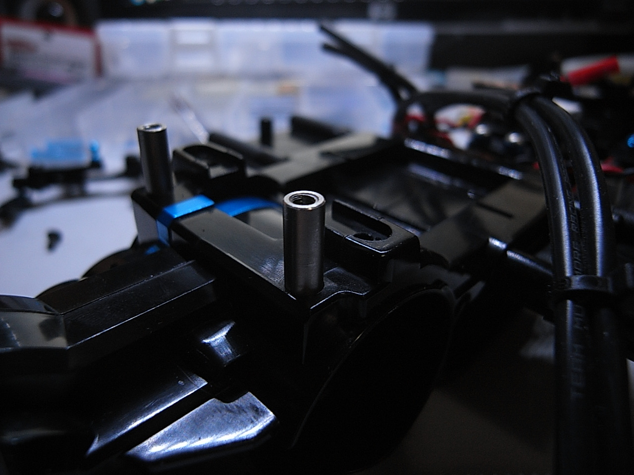

仲有一樣係件碳纖轉向板係用上兩粒3X6有邊啤令,即全啤令轉向,
唔行纙絲同膠磨擦,如果金屬轉向同金屬纙絲磨擦耐用程度會更底!

不如出條金屬柱用黎取代B3 個舊野仲好啦......超低成本制作~
清清 發表於 2009-8-7 00:55:08 | 只看該作者
lung1 發表於 2009-8-7 00:20
好fit位喎,值得參考
