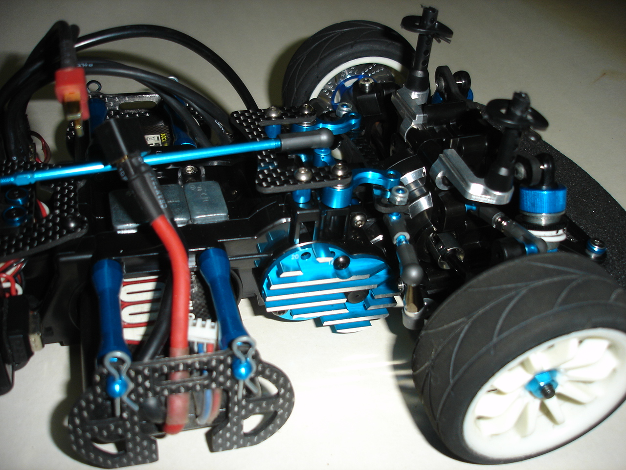

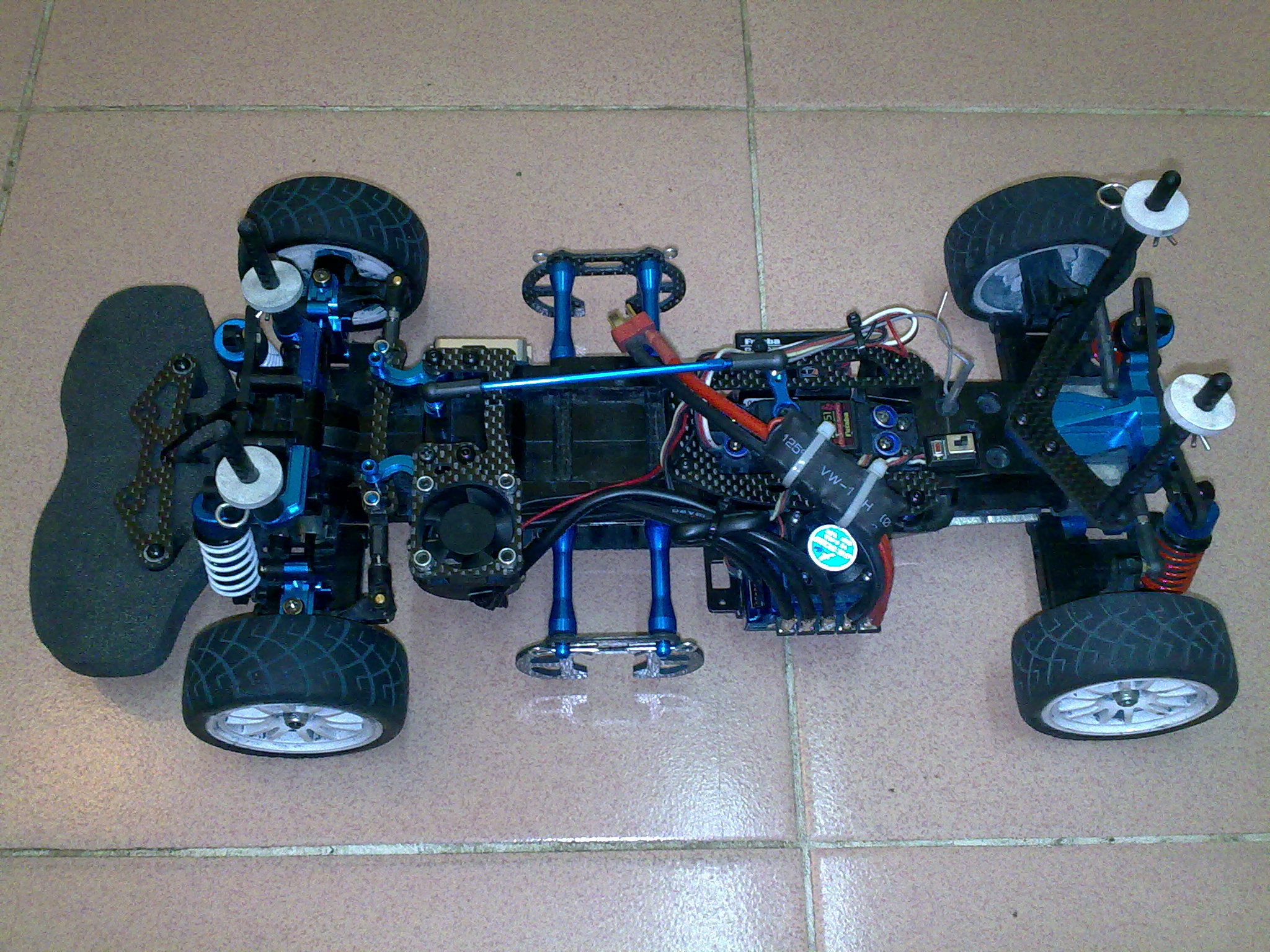

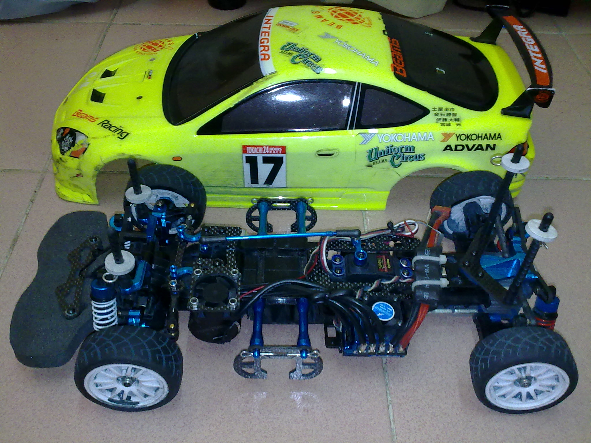

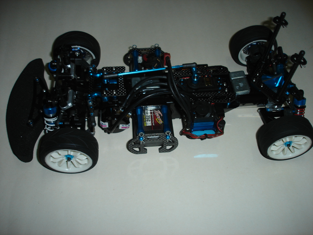

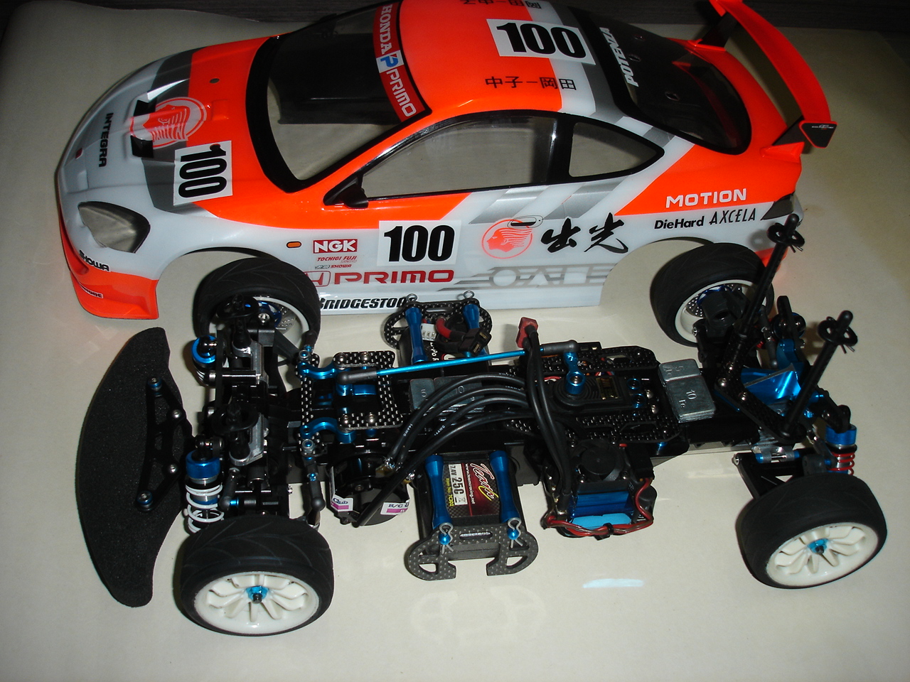

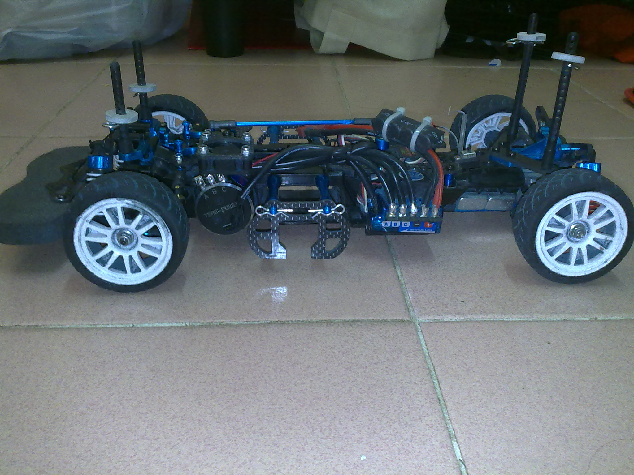

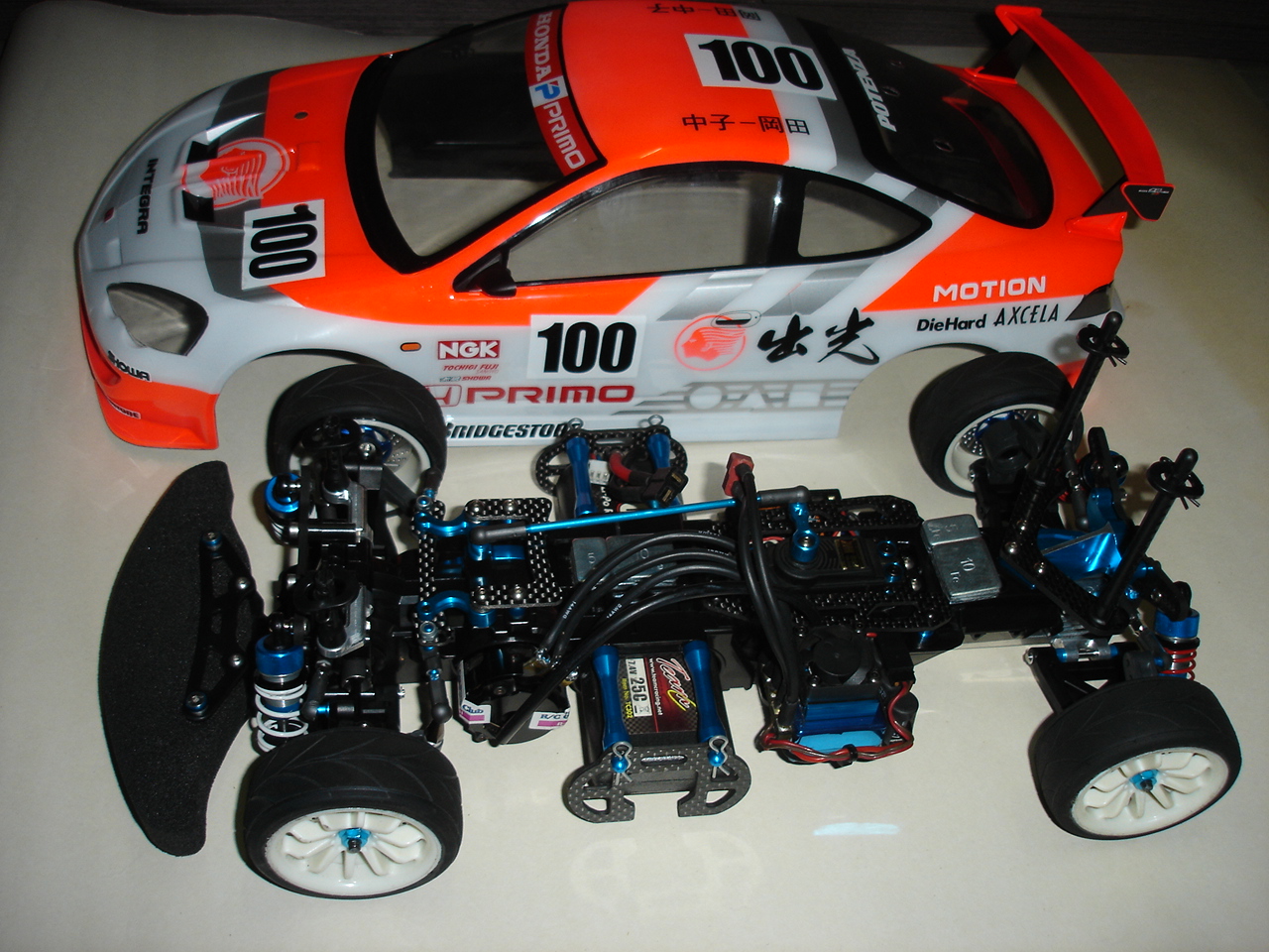

turbo997 發表於 2009-11-8 22:06:34 | 顯示全部樓層 |閱讀模式
I will use this machine to race on this coming Sunday
TC   (RCF race)
This car have best handling .

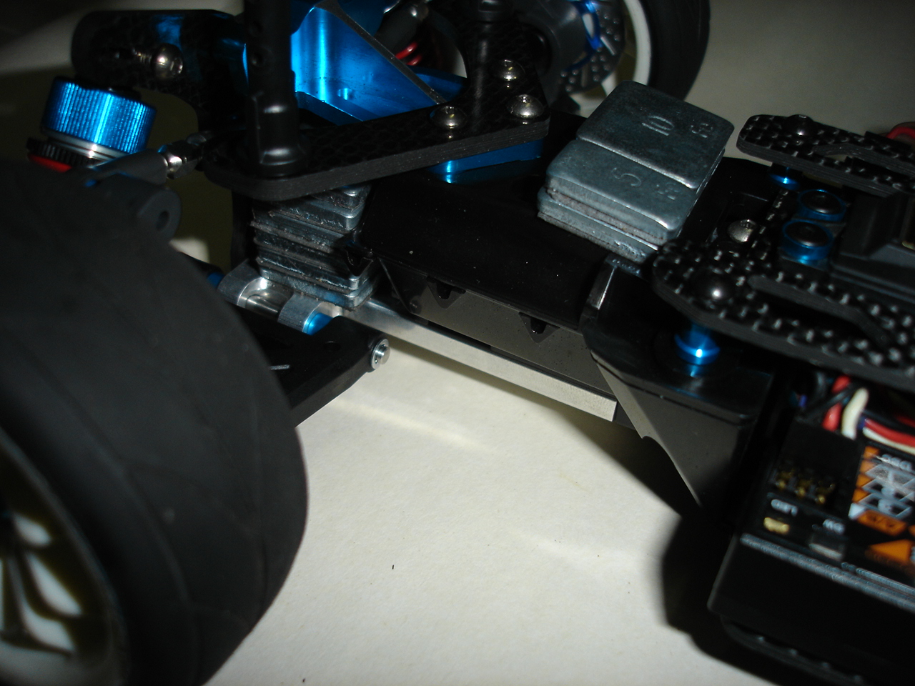

turbo997 發表於 2009-12-23 15:05
thanks and 1 more question, did you add weight at the tail? If so how many gram you added? does it need to balance head and tail weight?
I try empty weight at tail in TRC but it cannot drive =.=
 樓主| turbo997 發表於 2009-12-23 15:08:10 | 顯示全部樓層
92# hk_sdu
YEs
If use the short damper .The car will lower.ANd I use the top tire race in TC with the DC5 body is very good handle.I can tell all this car the front damper cannot soft.It will very diffcult to drive!!
 樓主| turbo997 發表於 2009-12-23 15:05:13 | 顯示全部樓層
91# kingman7788
Front is 5mm and rear is 6mm.
hk_sdu 發表於 2009-12-22 23:03:44 | 顯示全部樓層
90# turbo997
turbo997 thanks for your sharing, i think FF car is quite difficult to have good setting.
May i know why u use short damper? Is it same as M car damper? For lower ride height? BTW your DC5 body is super nice!
kingman7788 發表於 2009-12-22 22:35:04 | 顯示全部樓層

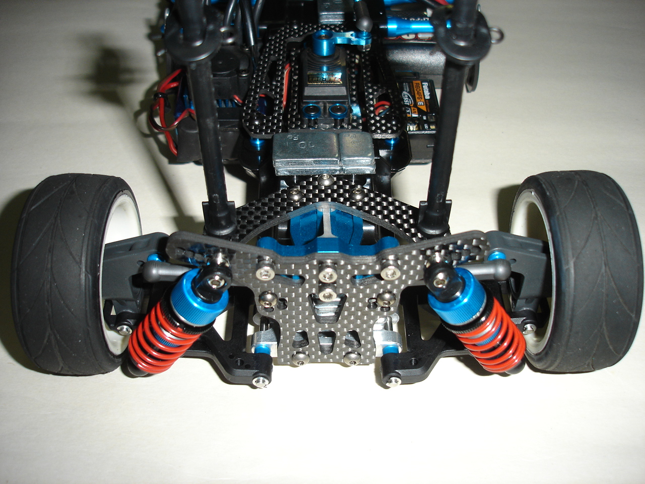

89# kingman7788
You can use 3 racing short damper set.Front shock use 2holes piston and 50 oil
And the rear shock use 3holes piston and 20oil
Front spring use Timiya white(touring) and rear use R ...
turbo997 發表於 2009-12-22 22:25
thank you so much , i just bought a TRF M chassis damper , will try to use this setting.
by the way how many mm of the ground clearance? 6mm?
 樓主| turbo997 發表於 2009-12-22 22:25:30 | 顯示全部樓層
89# kingman7788
Front spring use Timiya white(touring) and rear use Red (touring)
F camber is 0  And rear camber is 2.But I use DC5 body
And if you use sorex  I suggest front use 40  and rear use 32
kingman7788 發表於 2009-12-22 14:02:25 | 顯示全部樓層
樓主可否指點下,你個damper setting係點? 是否用M-chassis TRF?
chacha 發表於 2009-12-22 14:00:21 | 顯示全部樓層
年代久遠,唔多記得,冇玩 FF 車多年了,依家係得 M03
kingman7788 發表於 2009-12-22 13:51:09 | 顯示全部樓層
我以前玩 FF01 同 02 ,直路尾通常都有小小甩,用小小反手太救車,其他都冇咩問題,不過我就 set 有小小推頭(純粹個人分享同 set 車方法)
中速彎甩唔甩?試下尾再用低 D
chacha 發表於 2009-12-22 13:47
你damper點set? 用咩damper? 幾多度油?
