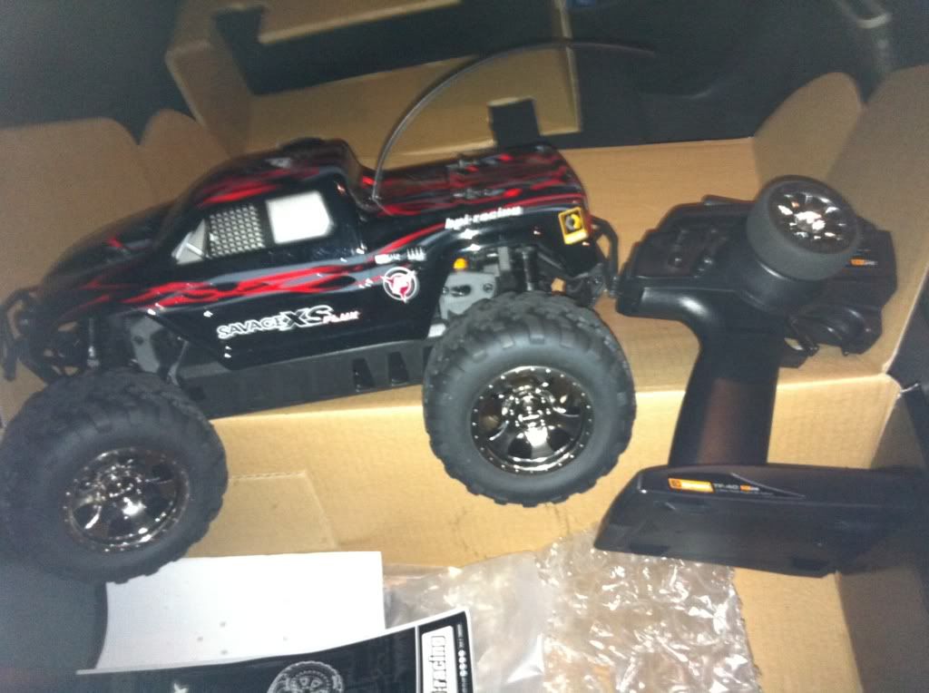

事原上次scte黎唔切貨, 所以改訂咗呢件,唔知有矛ching玩緊

got this thing last week~~~~alot of problem~
my advice is: sell the original sidewinder sv2 esc and replace with ezrun sc10($420 in kws)...
the first batch of that esc have some issue,some burnt when plug in battery~(real burn!!with fire!!)
some plug in battery and both esc and motor getting hot within 10sec(like me)~ (see urc or ask hpi china)
the most important thing is sv2 only 55amp and sc10 have 70amp!!
test taken on last friday,over 30min runtime, try 2s and 3s~no overheat,
wheelie and standing backflip
as i wish ~ after test,can touch motor and esc with bare hand~only warm~
Last 2 day one lhs tell me that hpi warehouse in U.S. have getting send back around 200 box xs
flux ...and they will release a New ver.(upgrade  drivetrain,using second batch esc,new sticker)soon...
