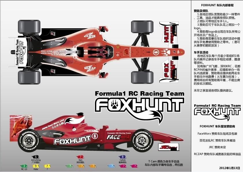

We are planning to group the people in South part of China to make Formula team race because we are new in RC F!, would like to know any comments or idea from all C Hing in HK.Anybody in HK want to join can contact me.
many many thanks.....rules as followings:

a)        车架
1.        1/10电动 F1 车架
2.        后轮驱动,不限品牌
3.        长<450mm,宽<195mm , 高<110mm 天线除外
4.        必须为F1仿真车壳
5.        必须着色,同车队必须为同样的车壳,包括着色,贴纸,同车队的车手应已号码及T Cam的颜色不同已作区分。
6.        必须有车手头盔
7.        必须有T Cam
8.        车辆全重>1000G
9.        尾翼空气套件不得高过T cam
10.        前鼻翼宽度不得宽果车轮最外侧
11.        车壳需于赛会注册,按先后为原则,它队产生类似的车壳配色需经先注册的车队同意,否则请更改。
