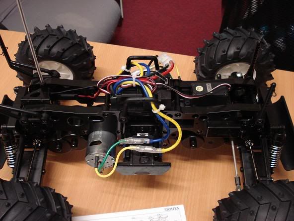

I had not stick the tire but didn't have yr problem. May be i ignore it during the play time.
i used Apex twin motor ESC with 2 black pig.
i have no idea abt the lipo cutoff![]()

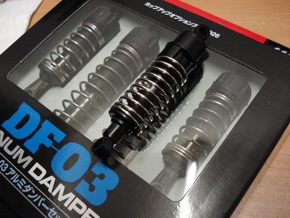

Your option DF03 damper is plastic. Just joking.![]()
Why didn't you buy the dual hunter which includes the ESC for two motors?
Someone modified it to 14.4V (dual battery).

師兄記住上實d個避震, 之前d post 話呢架車成日玩玩下鬆避震粒羅絲

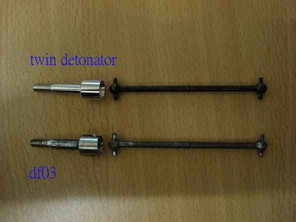

我試過, 握住條呔, 轉隻鈴, 係可以令到隻鈴轉但條呔唔轉^^" 咁即係其實行走時條呔係會有少許滑動. 不過既然說明書話唔好黐咁就由得佢.
原裝跟機械變速. 我已換了孖星 103. 但呢隻野冇 lipo cutoff. 如果有咁我 ...
如果你換的暴力摩打落去, 唔會掃齒不過會燒呔

但避震不足. 太硬同埋行程太短 ...
