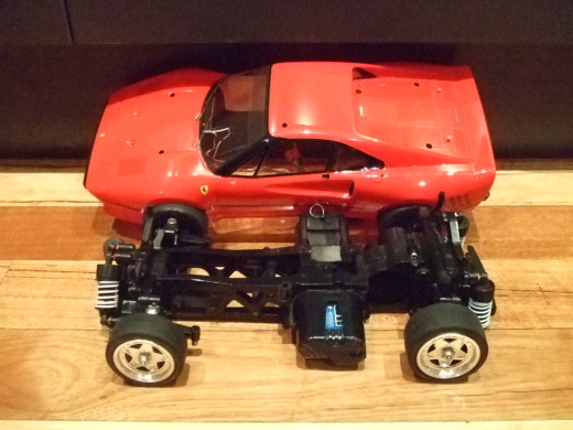

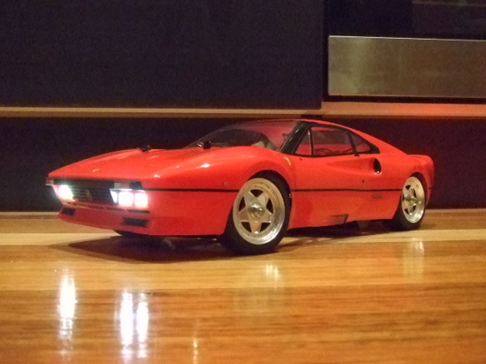

Here are some sneak photos of a "how to" guide I am writing on how to convert your M04L to a short wheelbase that will fit the Tamtech Ferrari GTO body.
The how to guide should be online in a week or so.

如果可以咁樣,都幾好玩喎,林寶個車頭咁低唔知裝唔裝到呢

Tamtech Ferrari GTO body =204mm Wheelbase
Tamtech Ferrari GTO body would fit on 1/12 pan car , i tried , that is ok .
how to fit on M04M(WB=225mm) ? Cut chassis ???????
i had inspect your pictures the secrets may be in the front sus-arm....
[ 本帖最後由 aydinkao 於 2008-5-18 15:55 編輯 ]

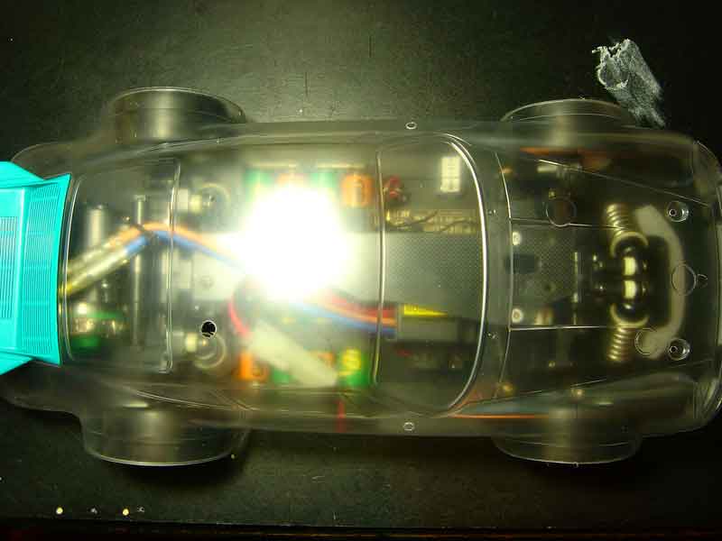

RX-7FD 發表於 2008-5-22 02:55:25 | 只看該作者
波子934 shell 唔得,輪距太短

Full instructions are now online:
http://rc-mini.net/MiniWeb_Online/Vw_To_Ferrari.html

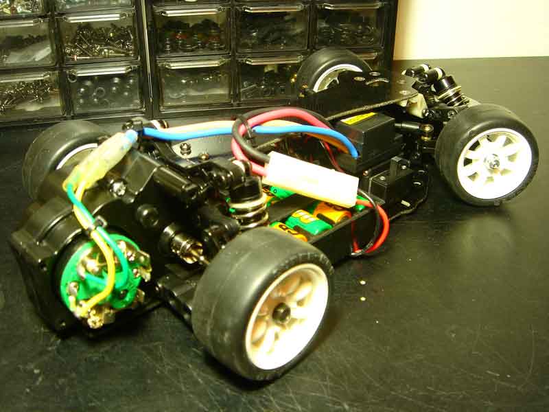

934 body? hmmm, that could be a bit harder, the new Martini 935 body might work, if the wheelbase is the same as the GTO.
bcgg 發表於 2008-5-22 16:42:15 | 只看該作者
原帖由 RX-7FD 於 2008-5-22 02:55 發表
波子934 shell 唔得,輪距太短
Porsche is ok, but need some diy

move7648 發表於 2008-5-22 21:22:32 | 只看該作者
原帖由 bcgg 於 2008-5-22 04:42 PM 發表
bcgg兄
你部... FF改RR!!??
