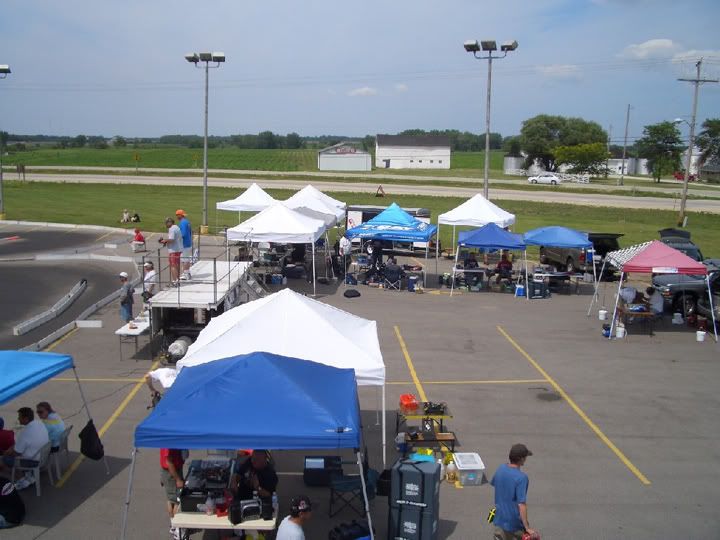

Racine track was very well known as "Technical" and "Challenging"....in my term of wording, that means "SMALL", 'TIGHT" and "BUMPY"..........when I say bumpy, it is really bumpy, like OFF ROAD type bumpy. From what I have heard, this will be the last year of hosting @ this location. There are already plans laying down for next year track location and promised it will be larger and smoother then what we have right now.

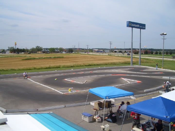

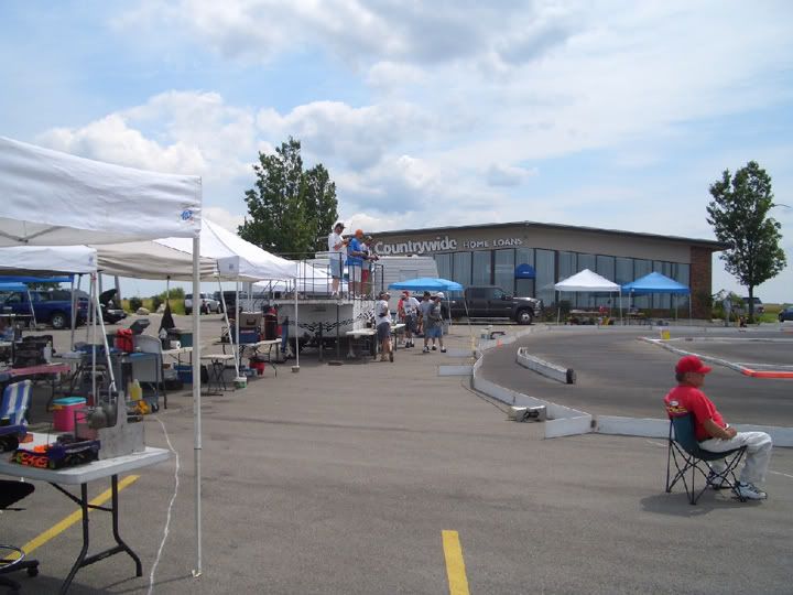

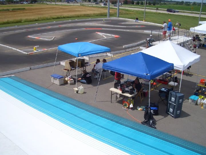

Next legs....MWS #5 @ Joliet Leisure Hour Raceway @ Joliet IL...back to my home track, the same track for Byron National. Here are some photos of this event.
1/8th Open B-Main
1/10th Open C-Main

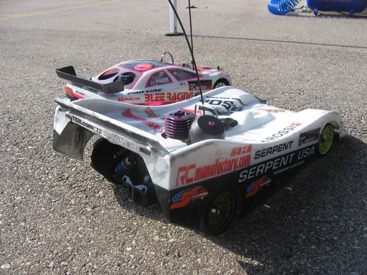

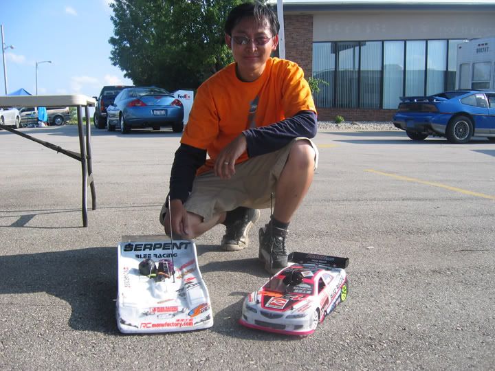

Serpent 950R - Blee Nova Rossi RX21-WC w/Michael Salven EVO 3 Lola

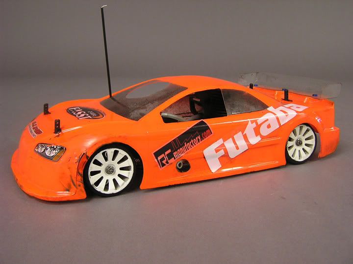

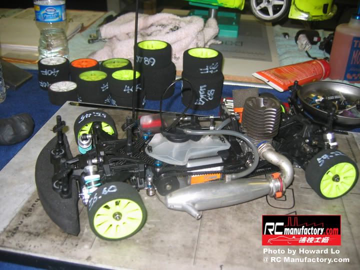

Team Magic G4RS - Blee Nova Rossi NS12T1 w/K-Facotry Missle Pipe Set.

1 months ago @ 2008 Byron National USA.........My G4RS w/Blee Modified NS12 TS1
