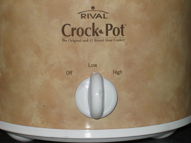

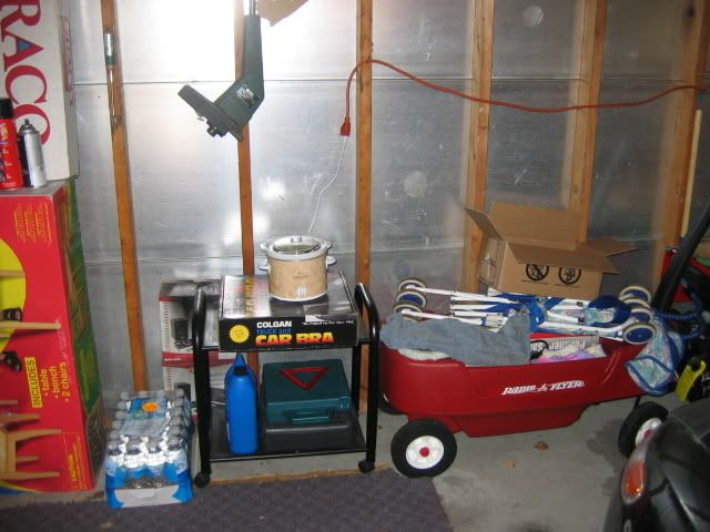

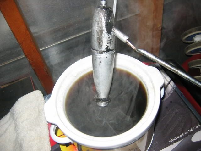

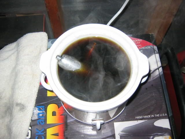

如何清洗1/10th and 1/8th 批而又可以洗到9成新甘神奇....
警告: 吾可以俾細路仔點到,睇到同 smell 到, 因為係有高温同有化學成份...我 high 到小小都燒到扒街,真係吾可以俾細路仔攞到...玩還玩,安全至上.
P.S.....以上資料係喺RcTech 同我一個 Mugen Driver Ira Schutt 題供, 佢重用以上方法去洗 Engine Body (bearing must be removed) 同 Engine Heatsink, 但 Heatsink Color 有可能改变, 大家自己去諗試吾試, 批我就 show 哂你地睇....Good Luck Everyone.
Yes, if you can get the pot and Anti-freeze and you have the SPACE to do it...try mine.

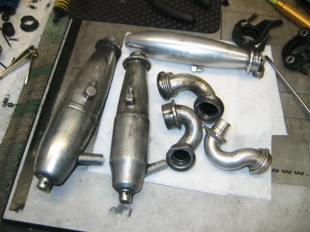

請問若如紅聲pipe 咁有電度鏡面,會唔會蝕到變啞面呢.作者: Optima2003 時間: 2008-9-19 00:31
One of the pipe I have is the 紅聲pipe 1/8th, 1.5 years, about 2 gallon usuage without cleaning. Use my methrod cleaned to 90% new...紅聲pipe電度面 after my methrod 唔會蝕到變啞面, you just need to POLISH it a little and back to the 鏡面. I didn't do it because I don't care and I am lazy.
For me, a pipe without the black grease and foams are GOOD enough, 花左 or 變灰色 does not bother me....good job.作者: pskyng 時間: 2008-9-20 16:06
