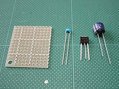

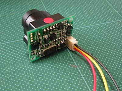

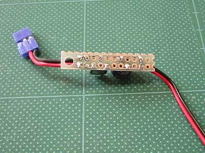

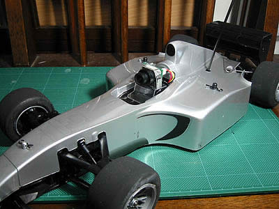

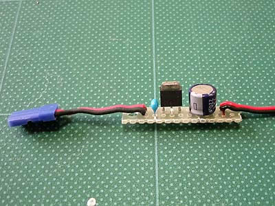

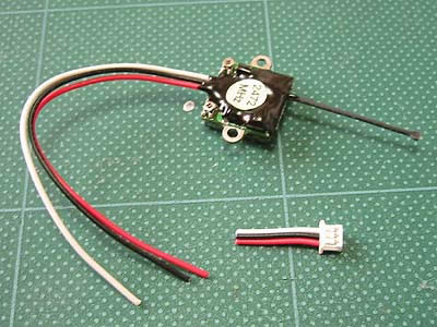

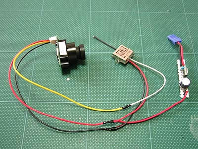

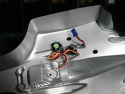

If I'm correct the 1st, 2nd and 3rd pictures is voltage regulator.  It is not too
hard to design.  The 4th picture is a camera.  You have to buy it from outside.
It is impossible to build it yourself.  The 5th picture is wireless video transmitter.
The transmit frequency is 2.472GHz.  Also, you need to buy it from outside.  It is
impossible to build it yourself.   The 6th picture is the complete item which
putting all the parts together.

只要知個 cam / transmitter 用幾多 v, 之後去 鴨記 買翻同樣的穩壓 例如用 5v 就買 7805, 用8v 就用 7808 再加粒 cap 就完成了穩壓組件了.
可否提供 原本的網趾, 再看看有無其他資料可給大家參考.....
