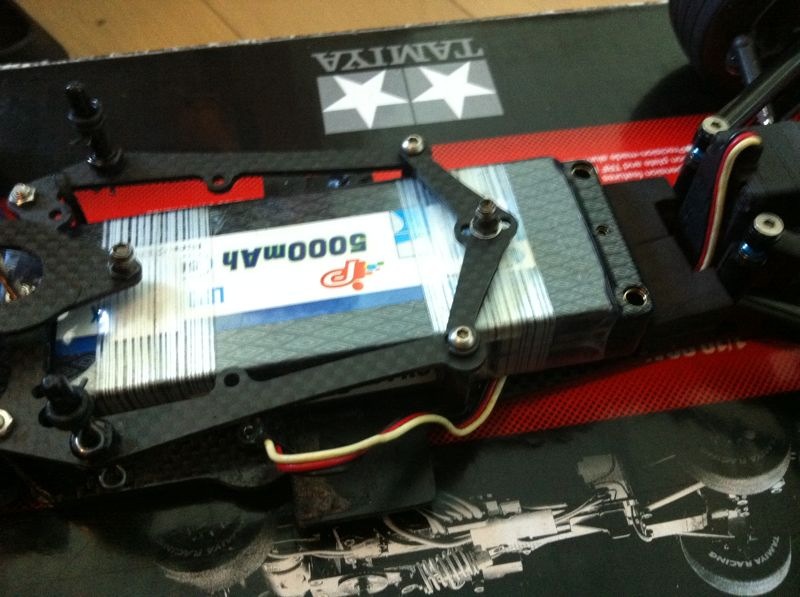

It is taken by my friend who used ZEN 2nd floor chassis.

I got that one the other day, at RCmart, for $27X. It works allow me to use square batteries. Since I only have square batteries. Will try out the car tomorrow at JV.

我以前都係感唸,但發覺好多快師兄都用短二樓板(不接頭枷),有的重特登去切短104長板。
原來有好處不只放方電,特別是104,啲彎不會太敏感,大快彎會園啲。車速因而加快咗。
