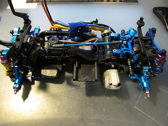

各位師兄 , 有冇發覺 m-05 嘅左右係唔平衡呢?
左邊比右邊重好多,加 30gm鉛都未平衡到,
請問師兄你地點搞呢 ?

我加左果大鉛,過右彎架車會咬D....左右都平衡

先天缺憾...無視之
不過遇著路面情況惡劣的話, 會變成左灣推頭, 右灣甩尾

make the adjustment on the shock absorber.

師兄用咗幾gm鉛?

would you please tell me how to make adjustment on the shock absorber?

spring and damper oil.
