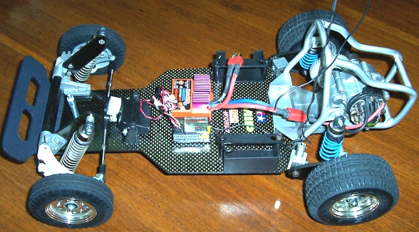

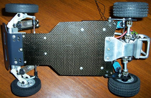

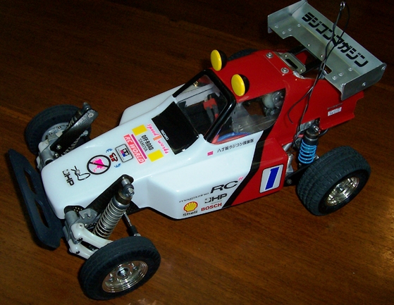

This one was an SRB Rough rider I got back in 1998 as a new built model. Then I added a custom chassis 3mm sandwich carbon fiber (super stiff), RCH front suspension arms, MIP trailing rear arms with its very rare CVDs/shafts, Thorp differential, machined down tranny, widened front end using carbon fibre tubes, mini servo with metal gears from Germany, mini receiver, JG roll cage, Yokomo titanium turnbuckles, MRP body, CRP wing,CRP bumper, RC10 battery cups, custom made rear gearbox underprotector, cut down dirt burner wing, Kyosho optima series motor slipper clutch bell   ......

But I wonder that the rear arms are strong enough??

 樓主| tiger1 發表於 2012-7-16 06:31:19 | 只看該作者
cfchung 發表於 2012-7-15 23:11
These MIP arms are never known for strength, as a matter of fact, most trailing arm designs are not known for strength. Therefore I used custom 3mm carbon plate rather than the original FRP.
 樓主| tiger1 發表於 2012-7-16 06:31:57 | 只看該作者
v8yw2 發表於 2012-7-16 00:50
cool 我喜歡後懸吊
Me too I especially like the rear shafts, very very unique, never to be seen in RC after

hihizaza 發表於 2012-7-17 20:58:52 | 只看該作者
條萬向好古怪喎!比近鏡睇睇
fat_fat_cat 發表於 2012-7-17 22:44:58 | 只看該作者
條萬向好古怪喎!比近鏡睇睇
just a fiber disc, we still use a lot in industries purpose, but no in hobby any more.
fat_fat_cat 發表於 2012-7-17 22:49:41 | 只看該作者
 樓主| tiger1 發表於 2012-7-17 23:03:23 | 只看該作者
can you show a similar industrial sample? What is the application??

fat_fat_cat 發表於 2012-7-17 23:14:00 | 只看該作者
just connect to a motor to anti vibration
i will try to found a pix later

fat_fat_cat 發表於 2012-7-18 01:04:33 | 只看該作者
 樓主| tiger1 發表於 2012-7-18 07:05:02 | 只看該作者
thanks for the photo
