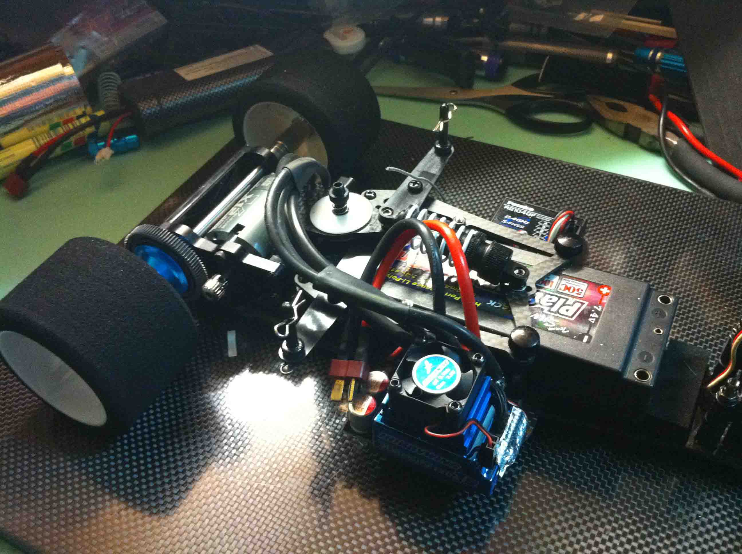

Hello all Pan Car Ching
Would you mind sharing your finished pan car (1/10 or 1/12, 扮Pro Ten 都得架), on and off shell here? ^^
Hope more Ching will join the Pen Car party !!!
Thank you very much !!!

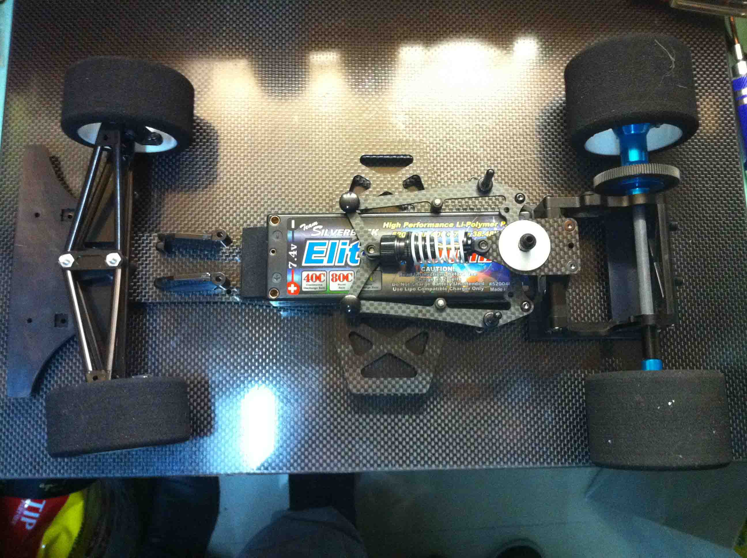

 樓主| mikuro 發表於 2011-2-1 12:09:49 | 只看該作者
hlsk 發表於 2011-2-1 13:35:26 | 只看該作者

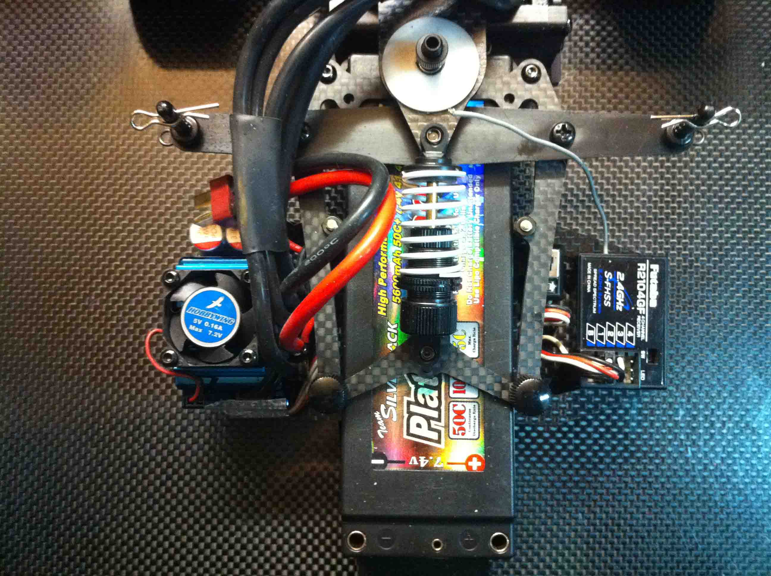

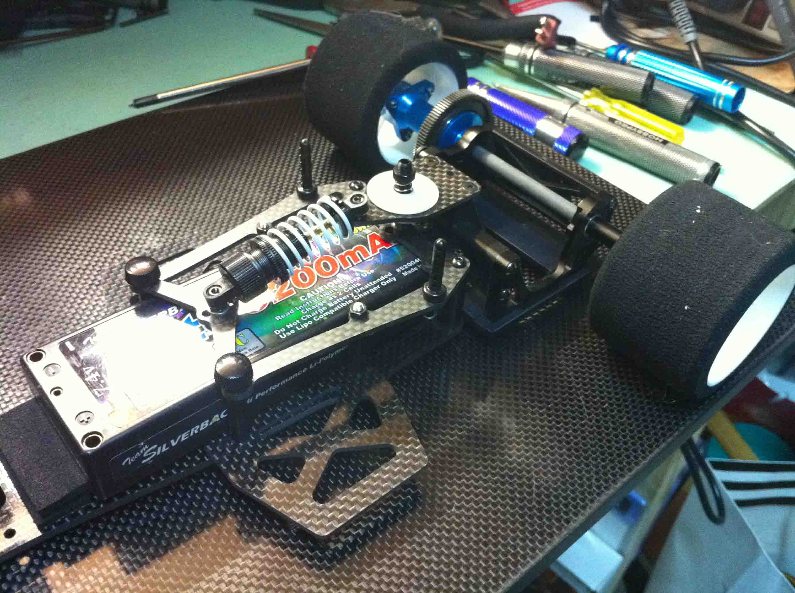

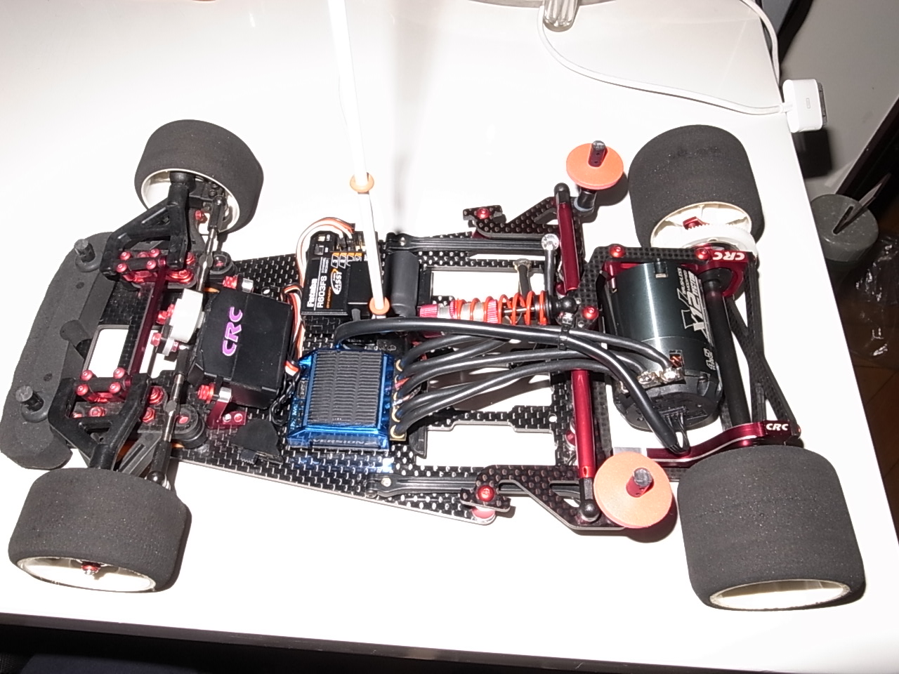

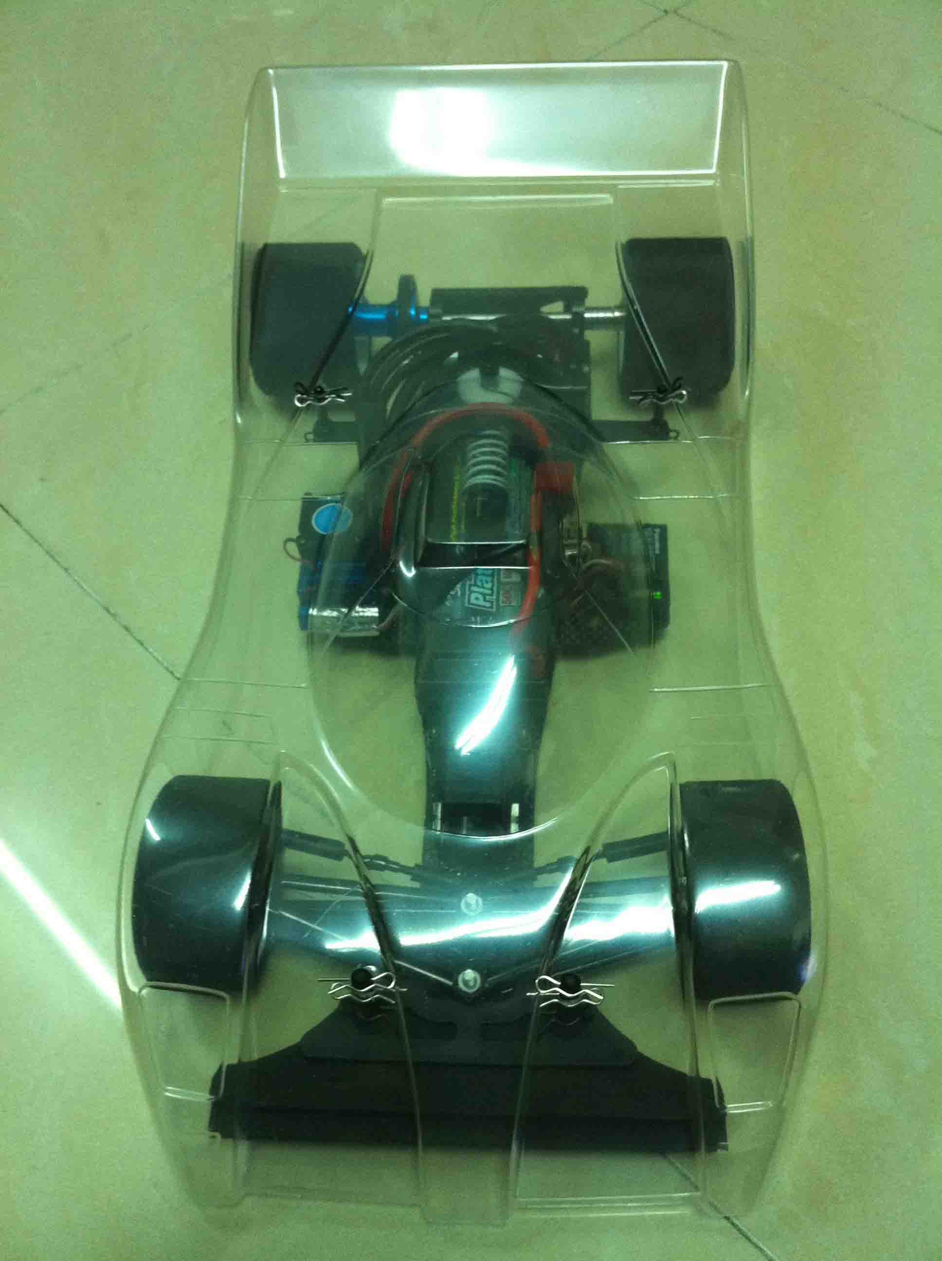

好靚,但個幾條摩打線頂住左條油壓,會阻住扭腰
 樓主| mikuro 發表於 2011-2-1 13:52:59 | 只看該作者
Hi Ching, my cable layout is not looking good but I have no issue on the damper since there is room under the body shell for the cables ^^

小小意見,個ESC線換16G,幼D,軟好多,減少對扭腰影響,原裝的太粗,太硬了,12仔可以幼D。用放在中間是ok的,因為成個12仔殼最高位就是中間,唔會頂住個殼(唔平),另外,所有電線的長度要小心處理,長短得宜,才不會影響扭腰,有錯請指教,謝謝!

小小意見,個ESC線換16G,幼D減少對扭腰影響,原裝的太粗,太硬了,12仔可以幼D。用放在中間是ok的,因為成 ...
derek5 發表於 2011-2-1 14:57

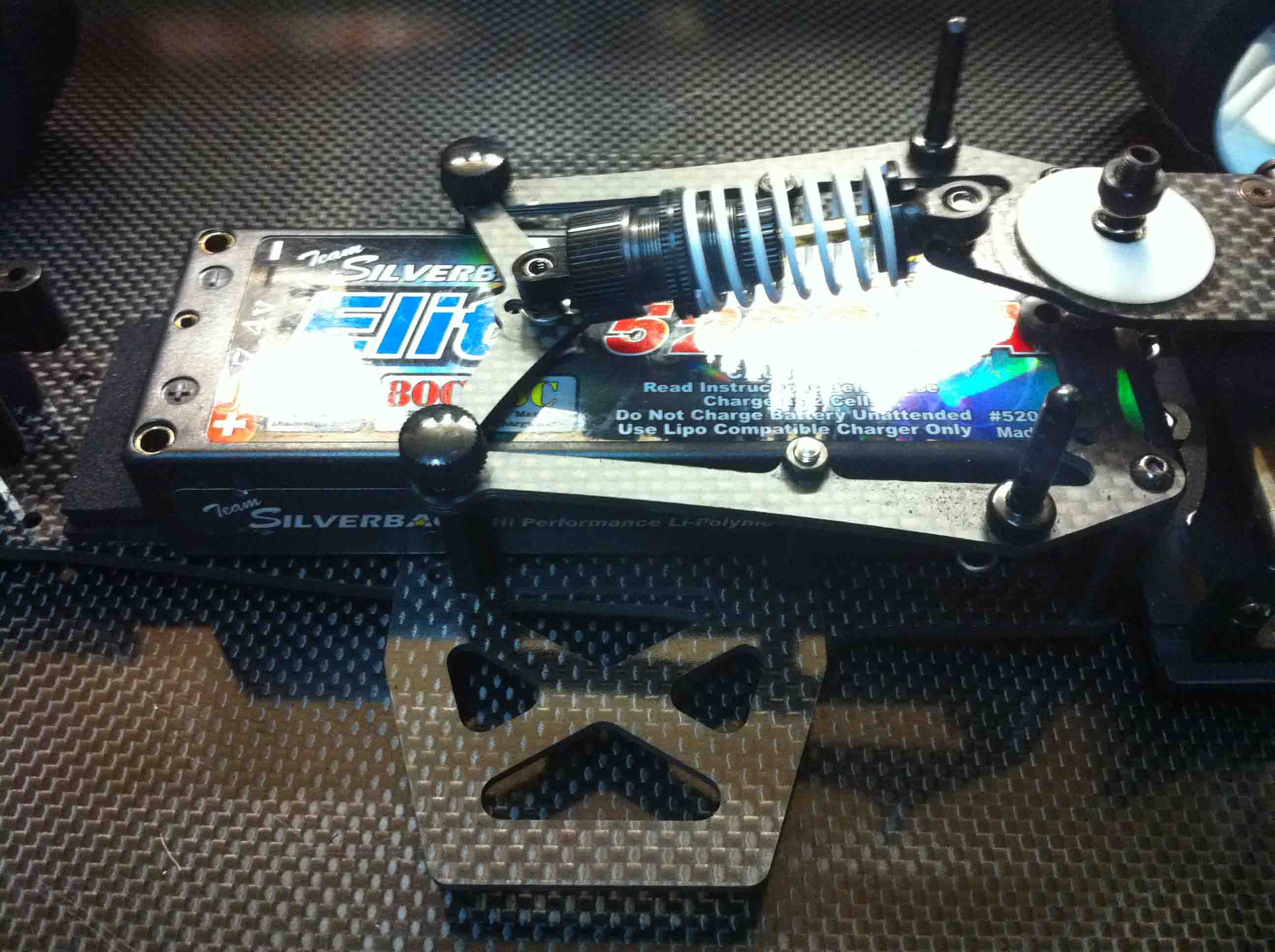

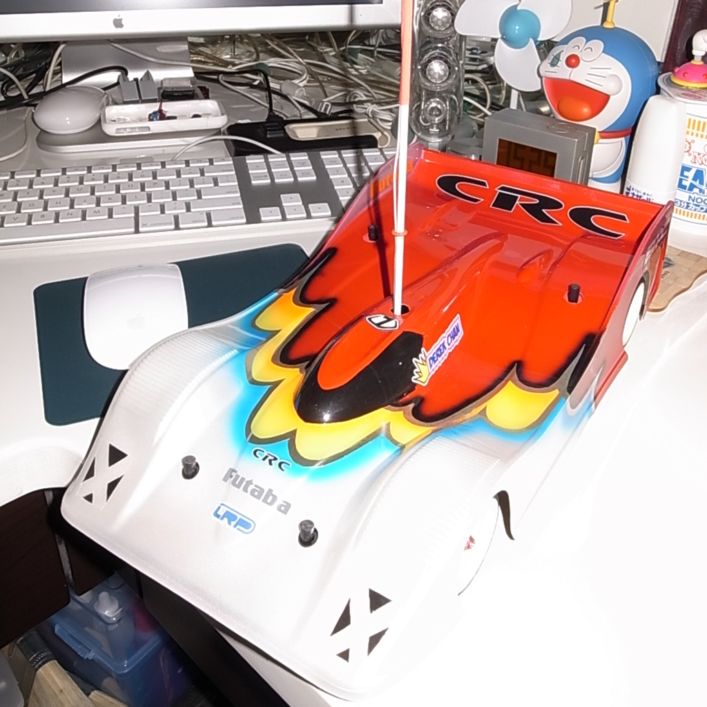

    Hi Derek, it is good to see more pan car coming. Your CRC is looking great ^^
    Can you show us your shell as well?
    Yes, even the built-in cable is still okay but I agree to change to thinner cables. Thanks for sharing ^^
    Btw, are you using 4.5T motor? Have you play at JV before? ^^

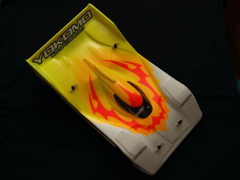

Nice shell. Thanks for sharing ^^

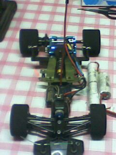

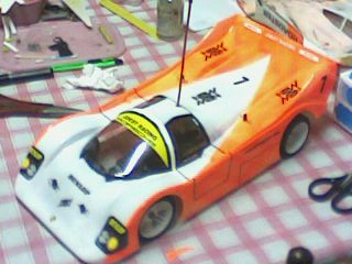

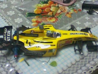

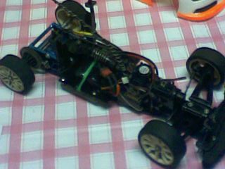

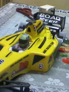

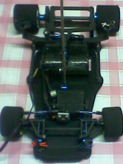

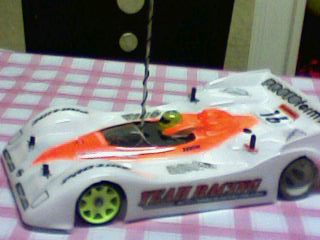

    First time show my F104 pan car here!! haha and some shell of 1/10 pan car

very nice....f37 r35 ?
f104 have a abc leman shell....if use normal oil car tire...it good fit (180mm width) as I saw one ching try before.....it is good because large range oil car tire degree can choice and more cheap.....speedmind oil tire only $90 1 set.......

    yes ar F37 F35! any other choice of the more solf rear tire??
