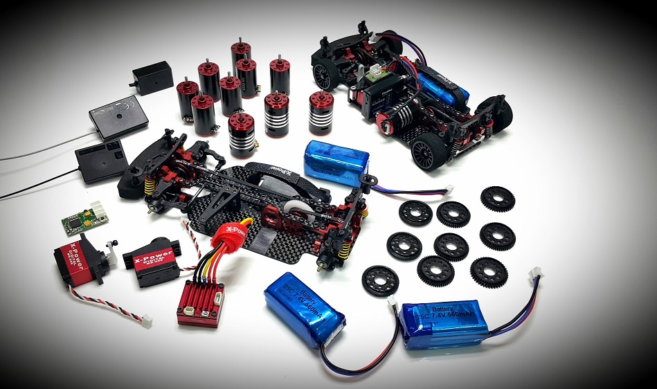

Today is the last day of 2014.  X-Power team is glad to announce that we have finalized our “Palm” sized touring project. It was named as IDT (“Indoor Touring”). This name tells us that it is going to be a “new" series of racing car from th⋯⋯ose called “mini" in the market.  It is hard to define what scale/size can be described as “mini”. What we can assure you is you are going to have driving/playing experience as if you were playing 1/10 touring but in a very comfortable “indoor” environment. We are a group of people who love radio control model very much. We would make our dream come true and share the enjoyment with you all.  Official release date will be announced soon. Before that let’s us show you more pictures of this IDT.  Happy New Year!
哥高查 發表於 2015-1-11 15:04:12 來自手機 | 只看該作者
請問差速 係 牙差定珠差,如果係牙差的話,係金屬齒定係膠齒,thx!
 樓主| X-POWER 發表於 2015-1-11 19:07:43 | 只看該作者
哥高查,IDT 跟車前後兩份都是珠差.謝謝

哥高查 發表於 2015-1-15 01:38:44 來自手機 | 只看該作者
本帖最後由 哥高查 於 2015-1-15 01:46 編輯
其實我都訂左部ultra 版支持吓,同時有幾個問題想知道1) 電變係幾多A數
2) 跟車會有埋摩打齒,大減齒(齒比係幾多)
3) 如果想買士啤件,如A臂,轉向杯,大減齒,摩打齒可以係邊度買
4) 彈弓可以用番京商ma020,還是要另配
唔好意思,一次過好似問左好多問題
 樓主| X-POWER 發表於 2015-1-15 18:03:04 | 只看該作者
2) 跟車會有埋摩打齒,大減齒(齒比 ...
謝謝你支持!
1) 電變係幾多A數  30A
2) 跟車會有埋摩打齒,大減齒(齒比係幾多) 跟車大減齒51T ,摩打齒10T
3) 如果想買士啤件,如A臂,轉向杯,大減齒,摩打齒可以係邊度買  零件就快會在X-Power website 有.可在廣華街選購.
4) 彈弓可以用番京商ma020,還是要另配  彈簧可用京商AWD DWS 的
謝謝!
