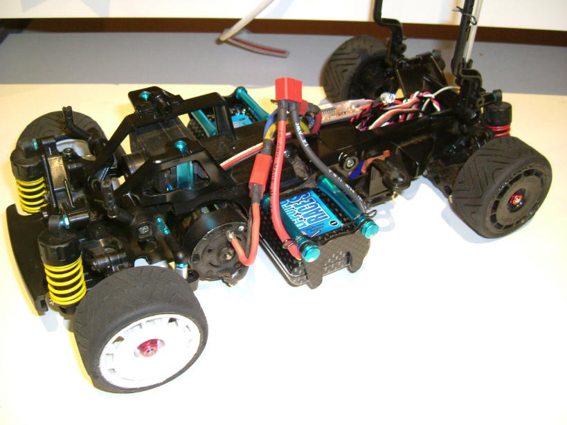

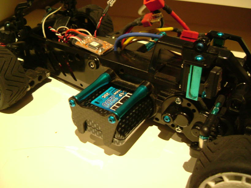

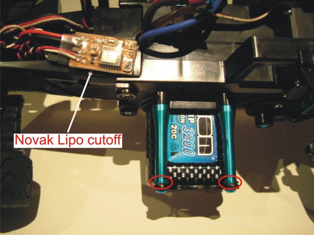

Thought I'll share some pics of my lipo install. In testing using a sport tuned motor the 3200 ran for 20 minutes before showing signs of slowing, then ran for another 8min 30seconds before the Novak smartstop lipo cutoff kicked in. In terms of power, the lipo pack produced identical lap times to my matched 4200SHV intellect stick pack.
The lipo weighs 197grams compared with 420+grams of the 4200. I charged the lipo 4 days before race day and it still provided the same power as the freshly charged 4200
In the last photo I have circled where 2 washers need to be added to allow for the extra width/length of the lipo when using the Tech racing battery holder. If using the standard battery holder you really need to change to a quick release M03/TL01 item and use more washers to space out even further.

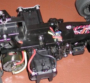

Rcplayer - yes, the 3200 fits the chassis nicely. The 3200 seems to be slightly longer than a 4200 stick pack, so the only modification I had to do was to install the Tech Racing battery holder and then add 2x 1mm thick washers to space the end plate out to allow for the extra length of the lipo. My friend runs lipo but his setup is different, on one side he uses the fixed part of the M03 quick release system using 6mm of spacers to space the fiber glass plate away from the support to give enough clearance for the battery, because of the extra spacers he had to use different screws to mount this piece as the supplied ones aren't long enough, instead he uses the screws which are used as the shock shafts in the friction shocks.
Pic of my friends install:
