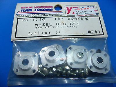

如題,
有冇C兄 , 記得點 改 adaptor / 用 CVD or 萬向改
有埋 材料 牌子/model 就perfert
Many thank's
依稀記得 MIP 好像有出過 12mm Hex CVD for Works 的

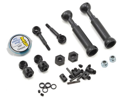

可以參考下呢個,有可能合你要求。但尺寸還是要細心對比一下的。
https://www.amainhobbies.com/mip-xduty-keyed-rear-cvd-kit-slash-slash-4x4-mip10130/p179493

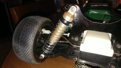

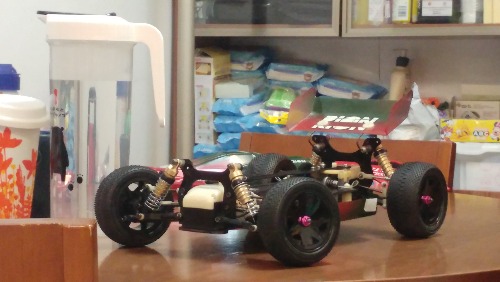

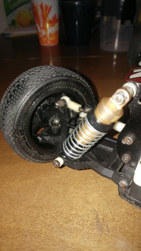

I have a YZ10 91 works change to 12mm hex hub. I use DB01 (yeah racing) 78mm Universial swing shaft in the front with changing the wheel side part to BD5. Still ok to go. For the rear, I still looking for solution. Currently using Top force dog bone but need to insert some o-ring or sponge in to the outdrives to keep the dog bone in position. 74-76mm CVD will fit the rear. Team C TM4 has 74mm Universal swing shaft but not sure the diff side fit or not. If you could fine MIP type CVD, it need 79mm (measurement is different as the joint location is not the same). Another solution which yet to try is combine the top force universal swing shaft and DB01's rear. A long wheel shaft plus 70mm swing shaft. But then the whole shaft will be push toward the diff side and need a 3mm width washer to fit in the gap.

shungyan 發表於 2017-9-8 14:11:24 來自手機 | 只看該作者
shungyan 發表於 2017-9-8 14:12:16 來自手機 | 只看該作者
shungyan 發表於 2017-9-8 14:13:44 來自手機 | 只看該作者

shungyan 發表於 2017-9-8 16:11:54 來自手機 | 只看該作者
Ching! 冇错! 提一提尾係用狗骨而唔係萬向(打住先)! 如果有tm4 74mm 萬向而個波波位入倒個珠差! 咁車轆side用top force 或bd5 就fit la! 仲有我部係870c 改咗91 works 手脚, ching 要make sure 93 works ㄧ様woo. 而如果有mip cvd, 79mm 就fit 哂! 轆嗰邊用pro4 應ok
