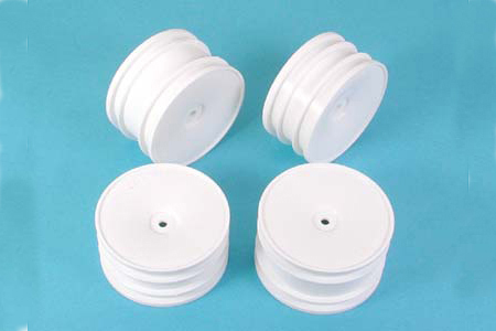

有無Top Force車主
可以幫我度一度頭同尾鈴尺寸??
我想知Rim直徑同闊度
唔該~~
li5115 發表於 2008-5-27 22:52:53 | 只看該作者
直徑 60mm,濶 29mm。
ryancmlam 發表於 2008-5-27 22:54:47 | 只看該作者
li5115 發表於 2008-5-27 23:05:15 | 只看該作者
Right. It 100% same as DF02 or you can use this one.
go2usie 發表於 2008-5-28 01:28:55 | 只看該作者
yes, this set is as same as top force size.
i have a set ~
go2usie 發表於 2008-5-28 01:29:52 | 只看該作者
頭24 尾29 ~

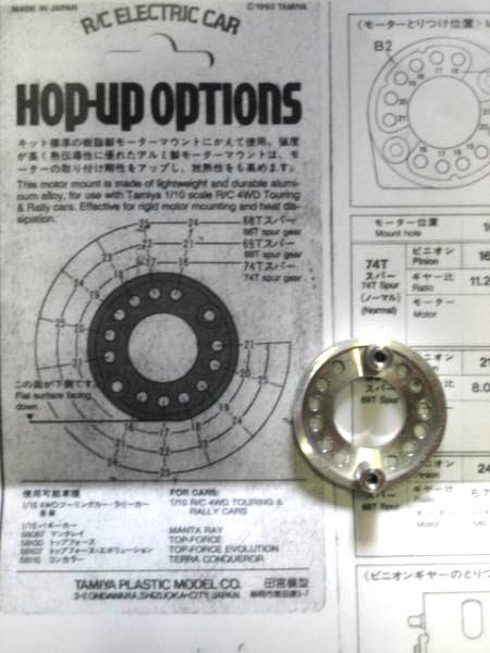

go2usie 發表於 2008-5-31 14:34:50 | 只看該作者
move7648~~
see picture if it can help about your gear problem....
see the manual on behind... i only have this pic i can find~
your 66T spur gear is "Skyline" fast gear ... not really suitable for big wheel.
for your reference only.

 樓主| move7648 發表於 2008-6-1 12:08:20 | 只看該作者
hi bro go2suie
finally i discover my 66T is coming with a set "Skyline fast gear set"
and my motor mount is not original hop-up option from tamiya
lucky, i found back my manual of the motor mount,
and i can find the fit position of the motor now
i have now install the 74T spur gear and also a 18T motor gear
and speed is quite good with my set Big Foot
but the white pig is still a little bit hot after rush run 10 minutes
(full spped on playground floor with a little bit wet, but DRIFT well )
anyway, thanks for your usful information, and i will try again with a lower motor gear
so, see u next TKO party with my TA01 there!
